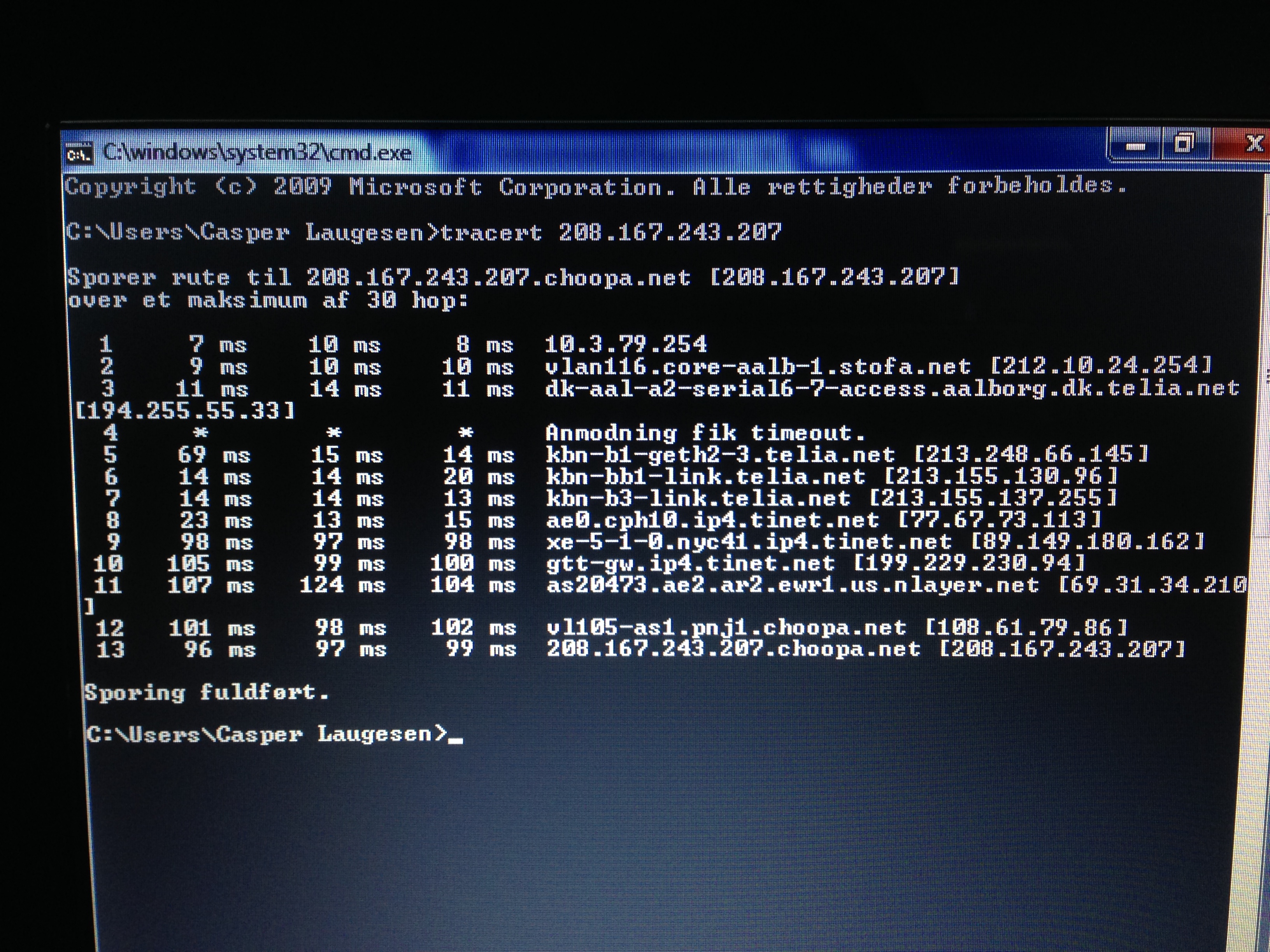

Please do the following; it is a way to track how you connect to the server and will help illustrate any potential problems for us to work from.
Assuming you are using Windows:
Click Start and click Run.
type: cmd
type: tracert 208.167.243.207
let it finish running until you're back to the c: prompt, then copy/paste all that info here.

Brown - I will post a picture of how it looks like when i'm connected to our DoDs server with a normal ping at around 100 with a total of 17 players - 16 players playing and 1 in spec. I will later tonight do the same when my ping is skyhigh/not normal.
While I was typing this message I stayed in game but alt-tab so I went out of game. When I went back to the game my ping was 84 and quickly went up to 100
The picture is taken on my iPhone 5 so I hope you can see what it says on the picture.
  • 0

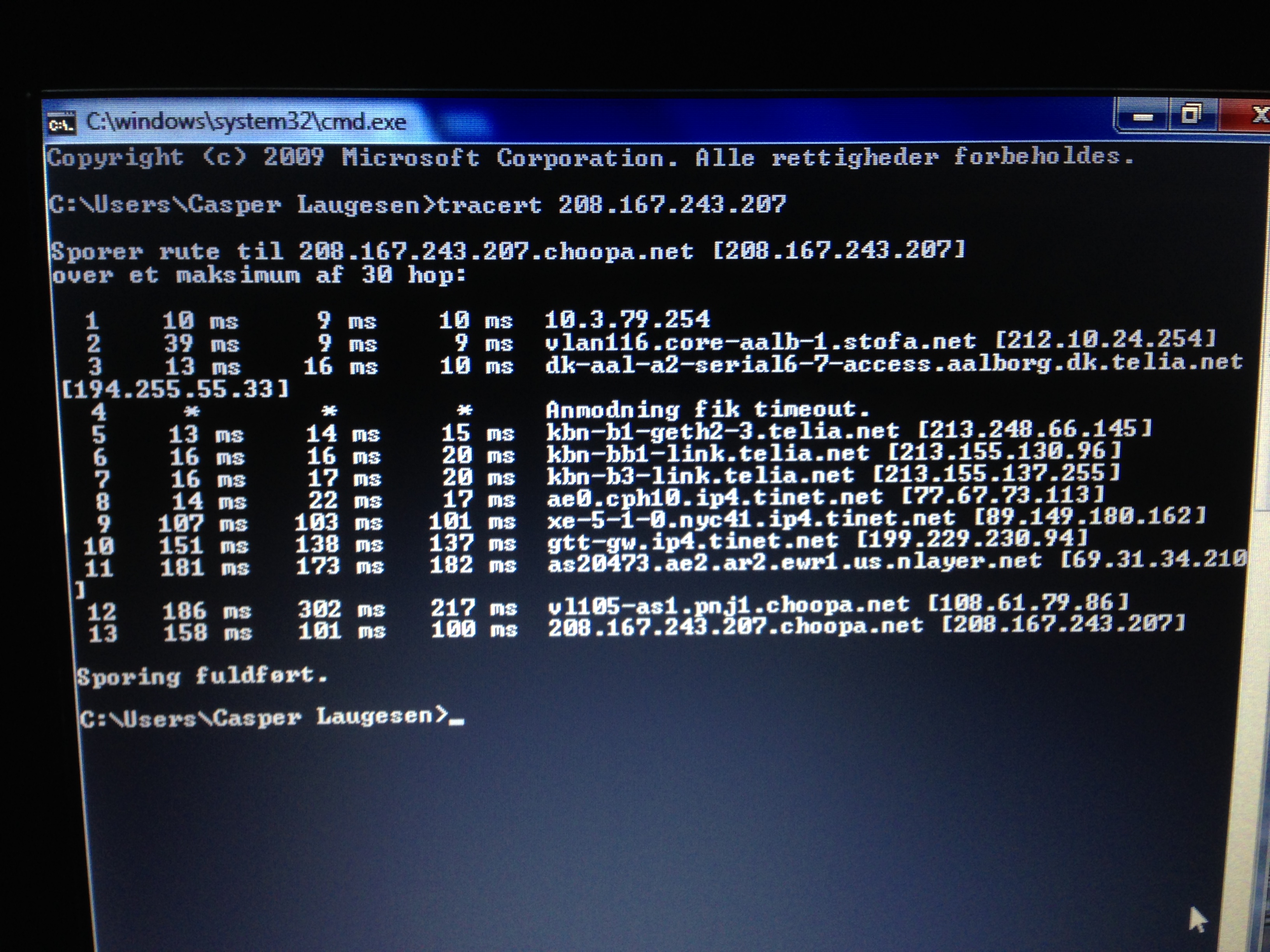

And this is a picture with the not normal ping. My ping is around 170 now. I can see that there is a guy from Sweden (Rec. Lennings) with a ping at 190 which is not normal either and I talked to Willow ealier and she said something about her normal ping is around 40 and it's now around 100-110.
  • 0

Brown - did you have time yet to look at the 2 pictures? :lol:
I did! It does support what your net guy said, that the problem isn't in your house or immediate area, but I have been noticing issues with the pub lately on my end as well.
I'll do some more research and post whatever I find out here.

I have an external ping going from California, New York, and Kansas to the server from dslreports.com. The graph is here at the link below. In some locations like California the ping is pretty steady where as in Kansas it has a rise and peaks throughout the day. I think that this shows more of an issue with the Kansas connection rather than the connectivity of the server since California is sound. In short I don't think that it is an issue with the server or the network it is connected to (at least so far).
http://www.dslreports.com/smokeping?target...40542&r=497
