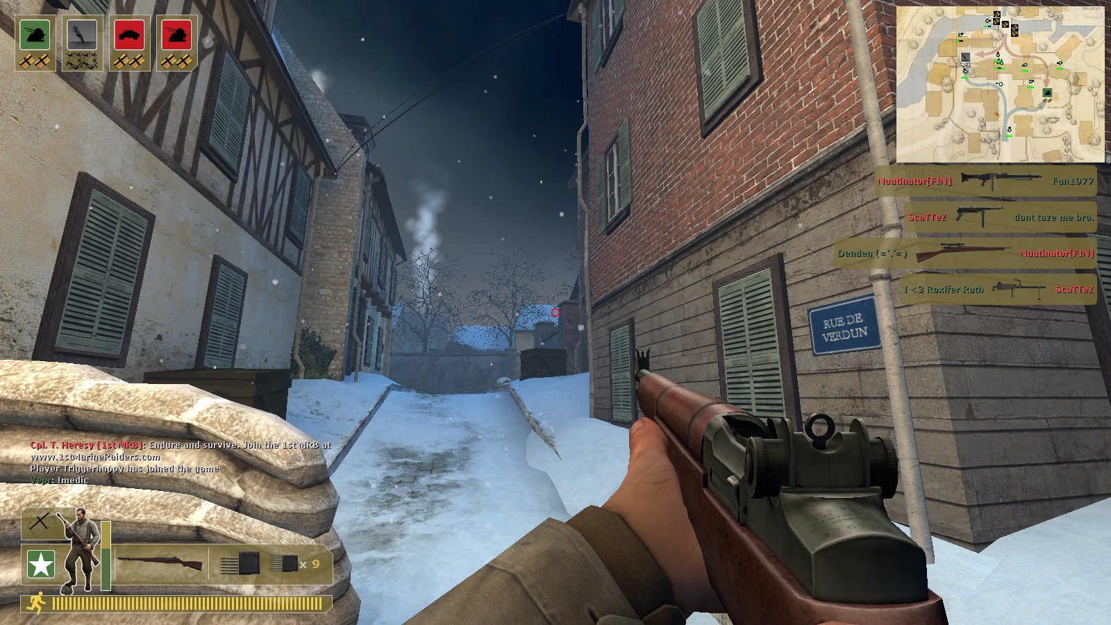

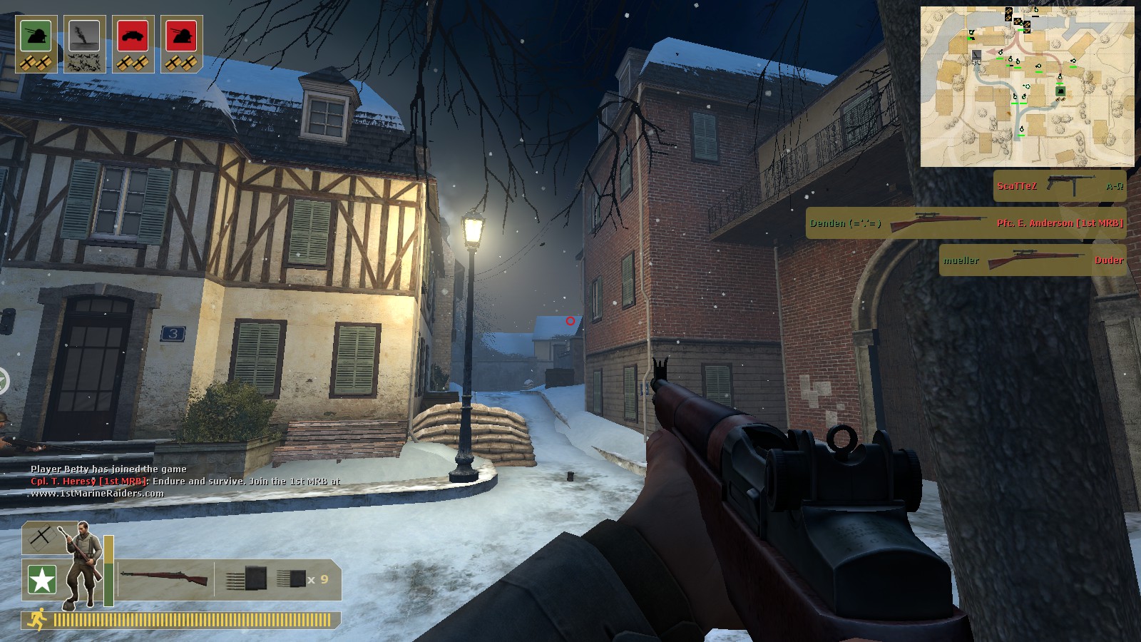

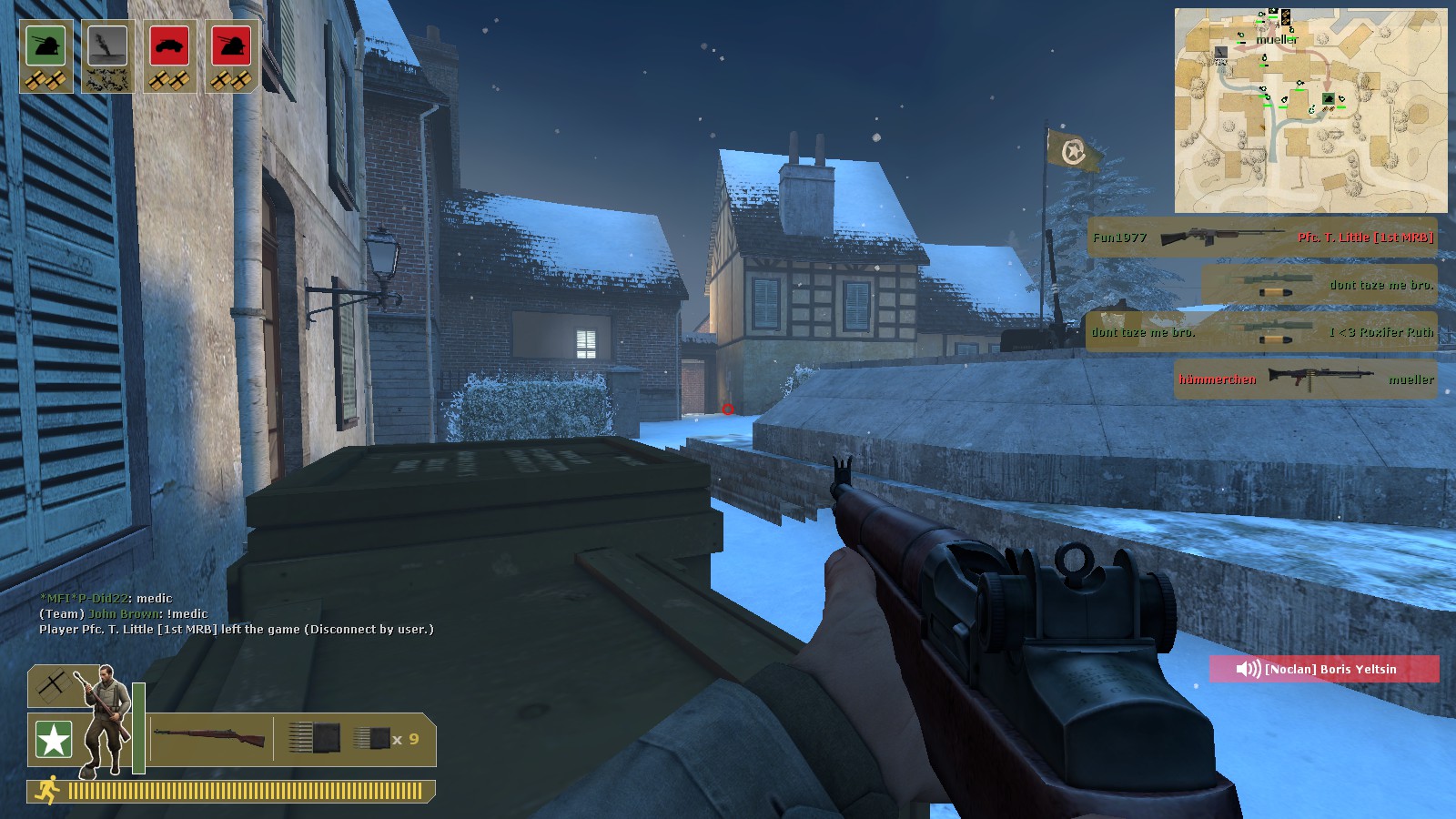

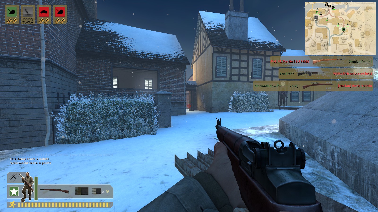

Brief Description of Issue: On picture 1 you can't see the door. Then on picture 2 you can see the door if you move a little closer. On picture 3 you can't see the tree but then on picture 4 you can if you move a little closer. I have tried all the different settings/verify integrity of game cache files and I even checked out my girlfriends DoDs game/steam account and it's the same error.

This is a result of the r_propsmaxdist variable in DOD:S. It sets the maximum distance for props to be drawn on the screen. This is likely modified if you use any configurations (it is not changed in Dillon's config).
However, you can change it manually by typing the following into your console;
r_propsmaxdist value
Where value = the maximum distance you want objects to be drawn. Default value in most source engine games is 1200.
*Warning* setting this value too high may have negative impacts on the performance of your game. Play around with it to find a setting you like, and if there are any issues, revert to the default setting.
